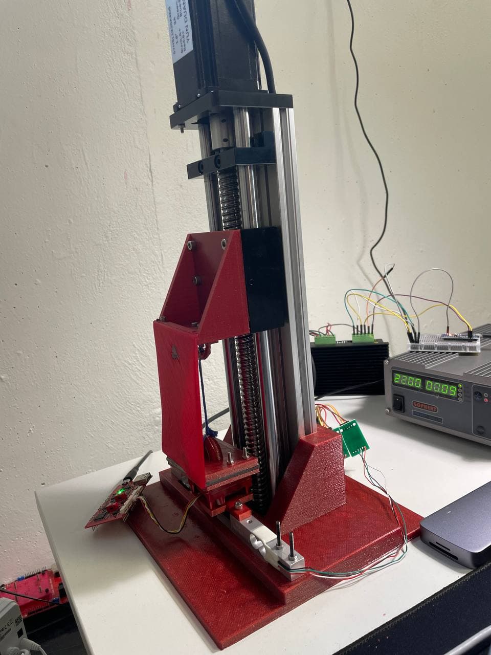

Step one was building a setup that would reliably measure the remaining magnetic force:
It works as follows:
- Using Cyphal/CAN the demagnetization values on FluxGrip are changed.
- The metal plate is placed on top of the magnet (it’s wrapped with 3d-printed standoffs to make sure it attaches properly)
- The magnet is magnetized and demagnetized.
- The stepper drive is turned on and it starts (slowly!) turning the metal rod which pulls the metal plate upwards.
- The strain gauges are used to measure the max force as the metal plate is pulled from the magnet. (It’s the metal bar on top of which the magnet is mounted, you can only see 1 in the picture, there’s a second one on the other side of the magnet.)
For one set of values, this process takes roughly one minute.

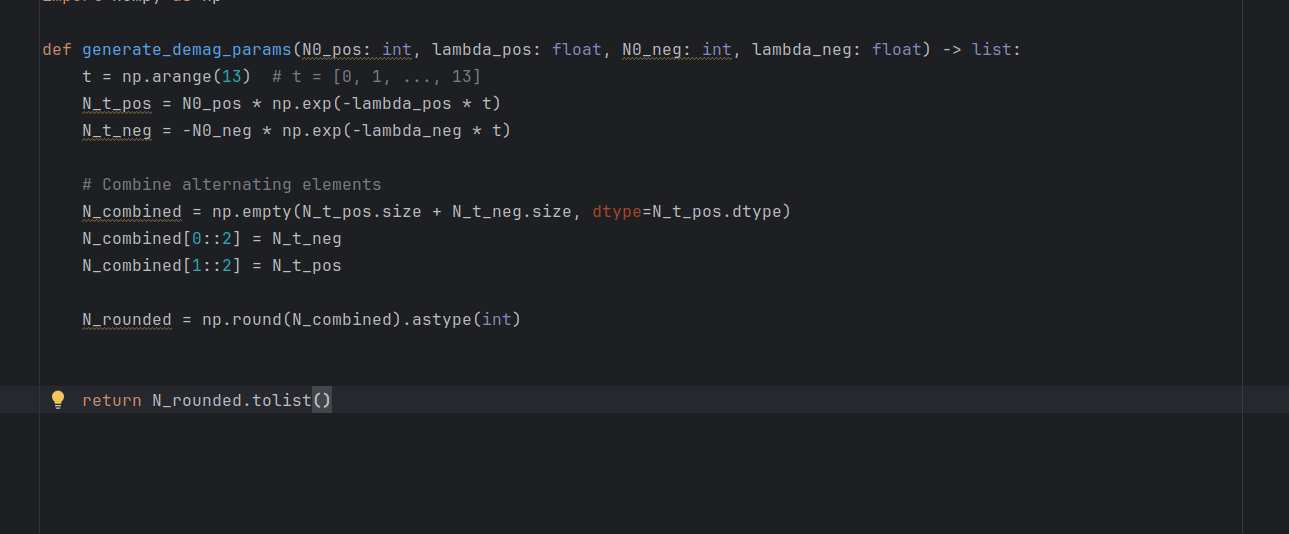

On Pavel’s suggestion I changed the approach slightly: instead of tuning 50 parameters, I would use a surrogate function that would generate these values from 4 parameters:
Above function generates 26 values but pretend it’s 50 (this was another dead-end where I tried to reduce the # of parameters by only tuning the tail end)
Anyway, this approach did not yield any result either. It would muck about, change values which more often than not would result in worse performance. I’ll be honest at this point I was starting to doubt whether it was possible to improve on the values we had at all?

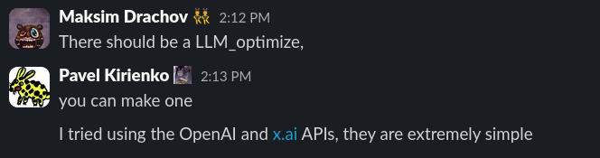

On the 3th day of tuning I decided to apply some of my patented “vibe engineering” to the demagnetization sequence, eventually I managed to find a set of values that reduced the remaining magnetic force from 5N to 3N. Clearly, it is possible,… but the optimization algorithm lacks the intuition to tune this properly. This is when I sent a Slack message to Pavel:

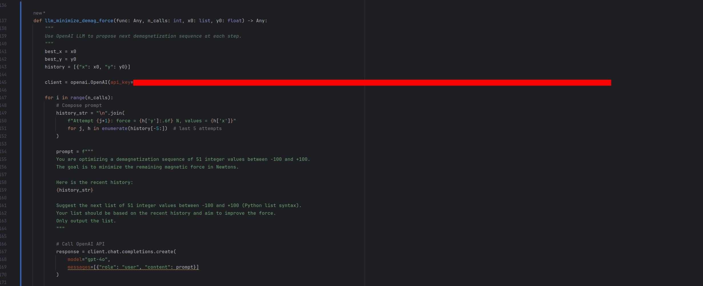

I had nothing to lose, so let’s try this. I threw out gp_minimize and replaced it with the following:
And boy did it start tuning! After just 26 iterations (which is insanely fast) it managed to reduce the remaining force to 0.95N. Then my setup failed (to detect when the plate detached from the magnet, a \Delta{}F>0.5N needed to occur). So I decreased this delta to 0.2 N and re-started. As I’m writing this it has already managed to reduce the remaining force to 0.62 N (which required another measly 25 test cycles). The speed seems mainly due to the LLM selecting candidates that seem indeed sensible to test, as opposed to the algebraic algorithm which tries to test absolutely everything under the sun (except for the values that would intuitively make sense).
