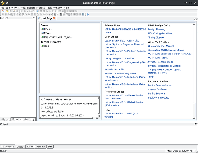

The resulting default UI theme may look a bit dated. Adding the following to the aforementioned ~/.config/Trolltech.conf may improve the appearance:

font="Noto Sans,10,-1,0,50,0,0,0,0,0"

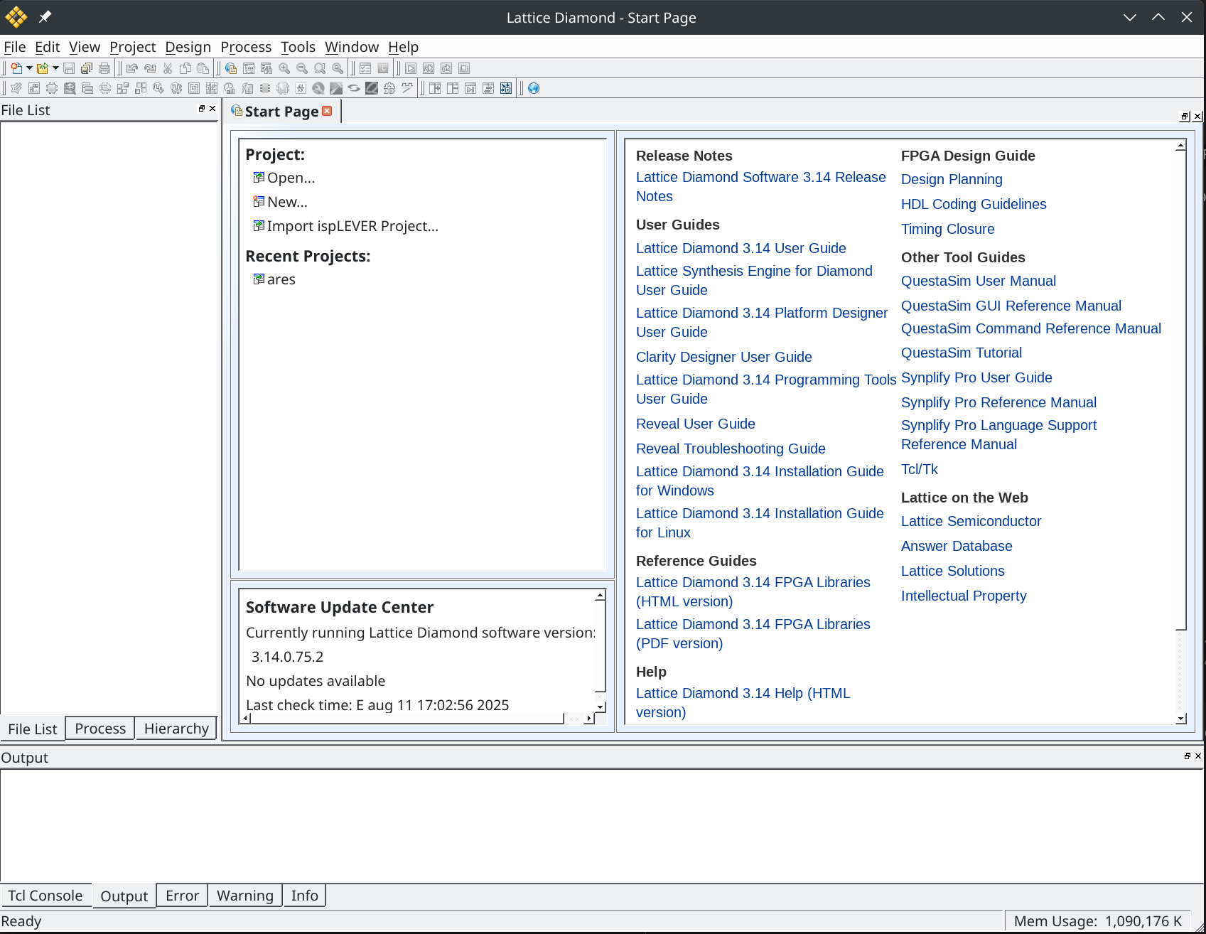

Once edited, Trolltech.conf must be made read-only! The config was generated by switching the global theme to the light theme once before launching Diamond.
The resulting appearance is shown below:
